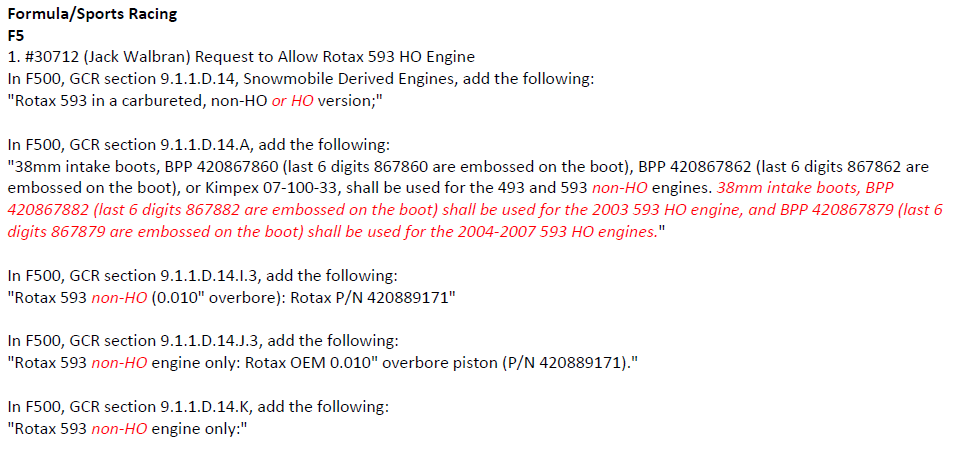

From the SCCA June Fast Track:
Fast Track June.PNG (53.94 KiB) Viewed 19745 times

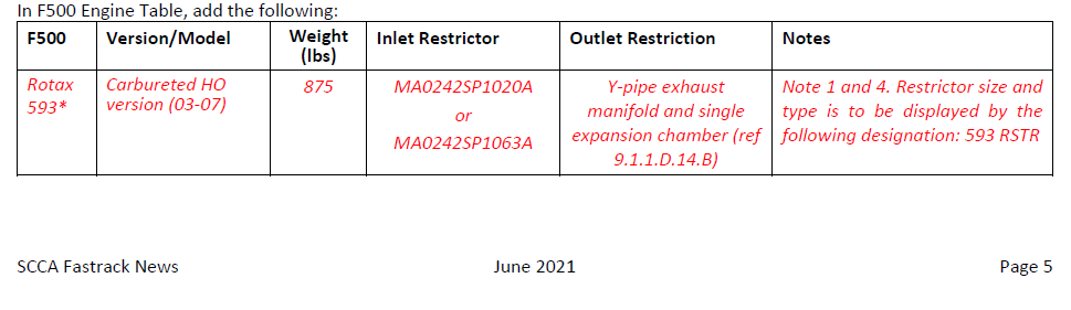

Fast Track June part 2.PNG (25.73 KiB) Viewed 19745 times
Thanks to Jack Walbran for getting this implemented.
